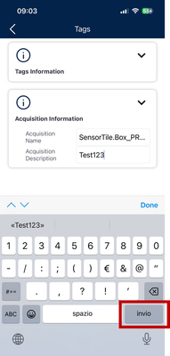

Once you wrote the desired name, did you click the “send” button on the keyboard?
I've just replicated your setup with both Android and iOS apps versions and it’s working properly.
Thank you for your valuable feedback. I can improve the documentation and add this to avoid other customers doing the same error.

Thanks Simone! That worked. I had been clicking out of the text field instead of hitting "send". I assumed it had sent or saved because the text field held onto the text when I exited the field or even switched to the Sensors tab. Thank you for helping me find a solution!!
