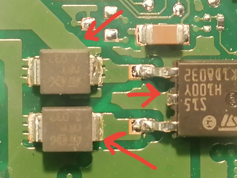

could not define this component
Hatyy
could not find the part number for this component (Left Arrows)
for the Right arrow, is it schottky?
thank you

It looks like you're investigating an automotive device right now?
As suspected, the DPAK on the right is the Dual Schottky Diode STPS15H100C-Y and the two SMB on the left are the SM6T30CAY.
