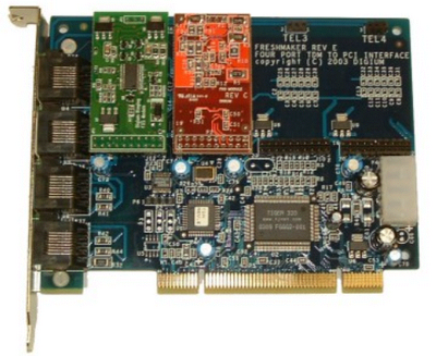

It might be interesting to research FXS and FXO modules (station interfaces) and then search for an MCU that can meet these needs.
- Green Module is FXS – Foreign Exchange Station
- Red Module is FXO – Foreign Exchange Office
wildcard_tdm400p_image273605
https://www.asteriskguru.com/tutorials/wildcard_tdm400p.html
