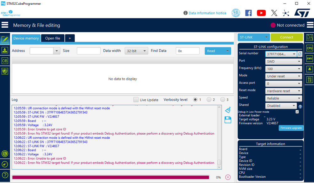

11:19:26 : ST-LINK SN : 37FF71064E57343652791543
11:19:26 : ST-LINK FW : V2J46S7
11:19:26 : Board : --
11:19:26 : Voltage : 3.24V
11:19:26 : Error: Unable to get core ID
11:19:26 : Error: No STM32 target found! If your product embeds Debug Authentication, please perform a discovery using Debug Authentication
I am using a LoRa module E77-900M22S that has incorporated a STM32WLE5CCU6. Also i am using a ST-Link V2 mini connected to program the micro. I have connected SWDIO and SWCLK properly and the module has 3.24V so the problem its not the connections. I dont know why it doesnt detect the MCU.

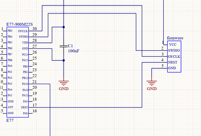

Please show your schematic for people to confirm.
A good, clear photo could also help.
You haven't mentioned VTARGET, GND, or NRST ... ?

This is the schematic of the connection:

Note also that the pinouts do vary.

To be clear, I have a clone ST-LINK but CubeProgrammer recognizes it and I can update its firmware perfectly just as seen in the image:
Even if it is recognized, does the problem "No STM32 target found" come from it being a clone?
Depends...
- CubeProgrammer should always work fine
- CubeIDE little bit more picky, but if genuine stm32 inside your "clone" , it should work fine
-- BUT : set to reset -> software reset !   Because the "clones" have no working hardware reset for stm32 !!!
