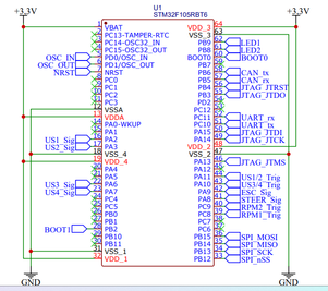

I am implementing CAN2 in STMCube IDE in loopback mode for microcontroller STM32F105. I have connected the tranciever to pins PB5 and PB6. this is the schematic:
I can transmit the data but I do not receive it. I am not sure but think I have some problem in configuration.
This is my code in STM32CubeIDE: AS you see I have highlighted the important part of the code. Help plz I don't know why I can not recive.
