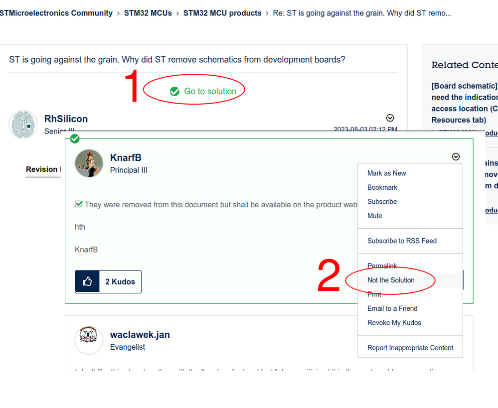

If the problem is still open, it might be a good idea to unmark the post already accepted as a solution (perhaps accidentally, due to a problem with the "Accept solution" button's update time) so that other users can try to help.
