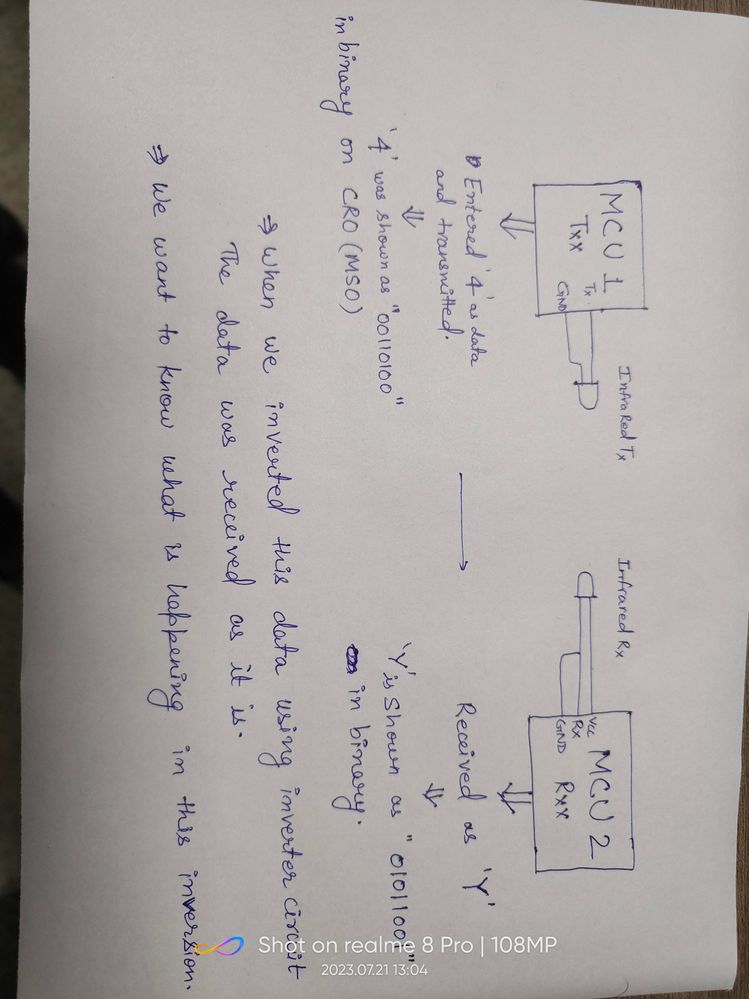

i am sending data on serial is 3 when is display is this 3 but i can conver in bninary then become 00110011 instead 00000011.and when i invert it then i got 01100110 instead of 11111100 ,why so ?

Ok, but what part / product are we even talking about here? Present the problem better, you'll get better answers..

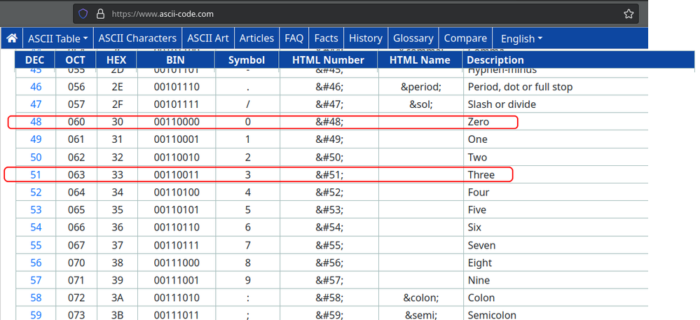

How is it possible to convert "3" in decimal to "00110011" in binary?
If it is "3" from the ASCII table then it is necessary to convert ASCII to decimal:
The value of the character "3" from the ASCII table is not 3 in decimal. The value of the character "3" in ASCII is 51 in decimal:
Table here: https://www.ascii-code.com/
Since characters start from "0" to "9", a programmer can convert the character "3" to ASCII by removing the value of the character "0" in ASCII.
This way the decimal value of the ASCII character "3" = equal to the value of "3" - "0" = (51) - (48) = 3 (which is 3 in decimal).
No inversion occurs anywhere in this conversion.
Note that the character "3" from the ASCII table is considered just a SYMBOL, not the relative position value (which would be 51 in decimal base, or 063 in octal base, or 33 in hexadecimal base).

your answer is correct for decimal to binary conversion but how i can invert it as a mention in my question ?
You're communicating the issue poorly, you're not answering questions to understand the "problem" you're attempting to describe.
Identify the part you are talking about.
Show the current code.
Show the current output.
Show how you want/expect it to look, and why normal output methods aren't working.
Is the question about flipping the bit state high or low? Or is this how to convert numbers to/from binary forms.

how to invert it?
Ok, but you've stated that half a dozen times already. Do you work with someone who can communicated effectively in English? Heck draw a diagram if that's easier..
Invert WHAT? For WHAT purpose? WHAT are you connecting together, and WHAT are the expectations?

when we inverted this received data ('Y') using an inverter circuit( using Transistor) the actual data ('4') which we were sending from the mcu , was received in Original form  (4).
our Expectation is to know the logic behind this inversion , so that we can directly use this logic in our program on the receiver end , and Receive the Original data without using any inverter circuit.
Seems to be a problem with the communication, what is the schematic for that IR part?
How is the transmission and reception via IR being handled?
