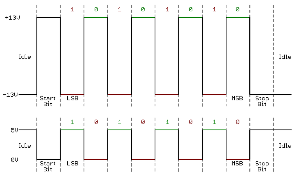

i am sending data on serial is 3 when is display is this 3 but i can conver in bninary then become 00110011 instead 00000011.and when i invert it then i got 01100110 instead of 11111100 ,why so ?

Hello
If external logic inverter helps to get right data, probably setting Rx line inversion on does the same thing (or Tx line). It seems that data is totally interved when it goes thru IR transmitter and receiver.
If you are using STM32/HAL/Cube you should find this setting under advanced features of Uart/Usart:
Maybe this way you finally get your data inverted :D
Br J.T

@Ranjeet Singh wrote:but may i know what operation they have used ?:D
It's a polarity reversal, so if the transmitter sends in normal mode, and the receiver receives with reversed polarity, the bits are reversed. It should look similar to what the bitwise function does (var2 = ~(val1);).
Note: The TTL signal (0V to 5V or 3.3V) is already inverted in the RS232 protocol, so it's good not to confuse things.
