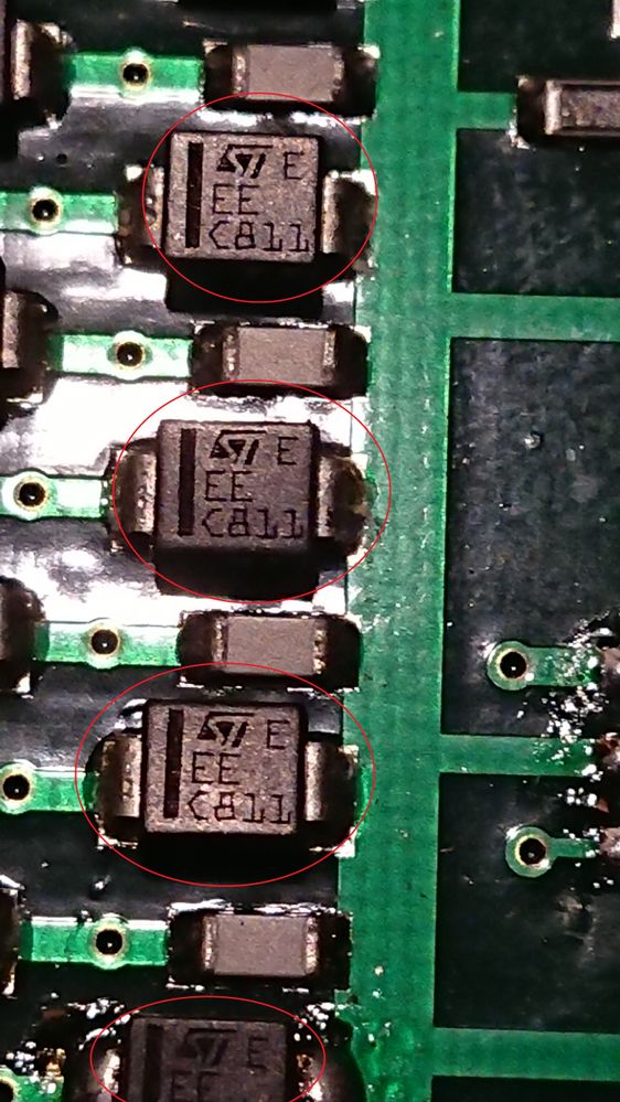

41/5000 I need help identifying a part

Please help!
I have an idea, information for someone about what this product might be and how it can be replaced. It would be urgent!
Have a good day everyone.
I ask for help with universal information that allows me to be uniformly unable to identify. Someone can already find with him what can be and what can be replaced. It would be very important, it can only be found in the off-road control unit of a single truck and cannot be used.
I attach a photo.
Peter BENSCH
It looks like a SM6T18A
https://www.st.com/en/protection-devices/sm6t.html
Good luck!
/Peter

TBodn.1
Hello Peter,
Thanks for the information, I also guessed diode, but I didn't know how to trigger it.
I hope what you recommended will be appropriate.
Thanks!
