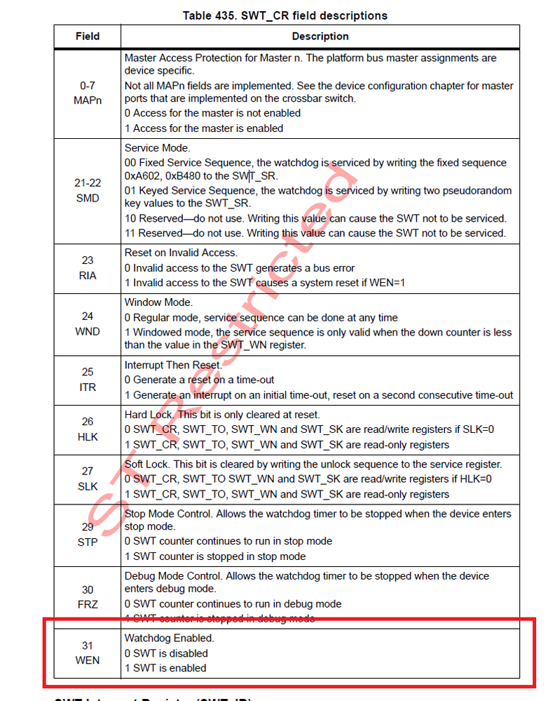

Hi guys,
i want to use the swt.
My Init Code:
SWT.SR.R = 0xC520;
SWT.SR.R = 0xD928;while (SWT.CR.B.SLK == 0x1);
SWT.TO.R = 0x0F42400;
SWT.CR.R = 0xFF00014F;My Service Sequence:
SWT.SR.B.WSC = 0xA602;
SWT.SR.B.WSC = 0xB480;For Testing, I service the Watchdog an stop servicing after 10 second. My Problem is, that the WD don't reset the System.
When I use the Debugger, i can see that the SWT_CO stands still.
Can anyone help me?

Hello David ,
in the register SWT_CR,
you have disabled the watchdog (Cf Screenshot)
SWT.SR.R = 0xC520;�?
Best regards
Erwan

Sorry David , it is my mistake
You have well enabled the WD (confusion between SR and CR)
you have kept FRZ bit to 1
it means SWT counter is stopped in debug mode.
could you disable it ?
Best regards
Erwan

Hi Erwan,
no problem, it's an confusing Controller.
When i set the frz bit to one, my controller become a reset in Debug Mode.
And i found out, why i could't see the SWT Counter (SWT_CO). It's only visible, when the WD is disabled.
The only Problem i have is, that i get just one Reset. (with or without debugger). Do you have an idea why that could be?
