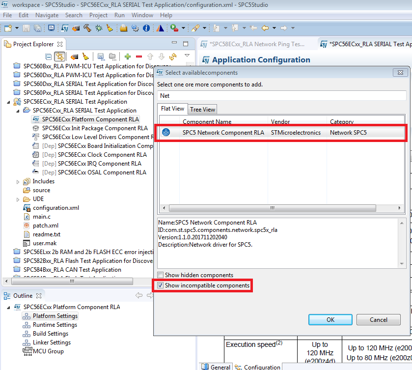

I try to test different component on my custom generated board based on spc56ec64l7.I already tested spi,linflex on board.Now i want to test FEC but finding no clue how to add this component and its driver in project because if i use  RLA platform component than there is no option for fec and if use only platform component (i think its from hal) than there is option called MAC but its not accessible. And i don't find any example for fec.i am using spc5 studio (5.6 version).Can any one help??

We have not some example application for SPC56ECxx family using FEC.
we have some SPC5 network Component RLA compliant 58 Family only.
i think that the FEC is the same.
You can pick up some source code in
c:\SPC5Studio\eclipse\plugins\com.st.spc5.components.network.spc5x_rla_*\
and reintegrate it in your application.
Anyway , i am creating a Change request to render this driver compliant for SPC56ECxx
