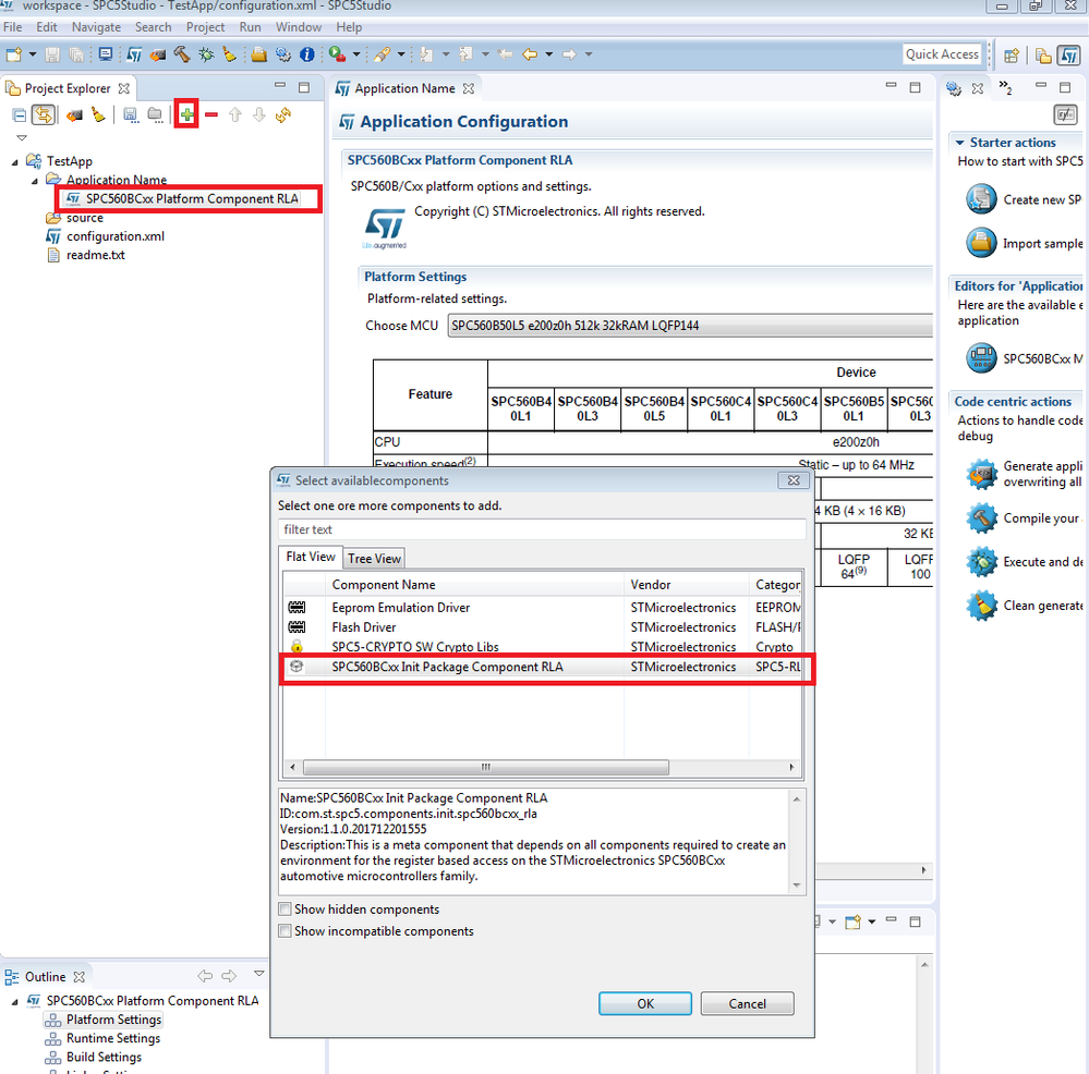

I've upgraded to Version 5.7.1 (my Config is attached).  When I create a new project, I do not have any of the RLA components available except the Platform Component RLA.  I also notice that the new project wizard is changed/gone since I updated to 5.7.1.  Please see a video of this issue here:
https://www.youtube.com/watch?v=efx_mE-9T4c&feature=youtu.be

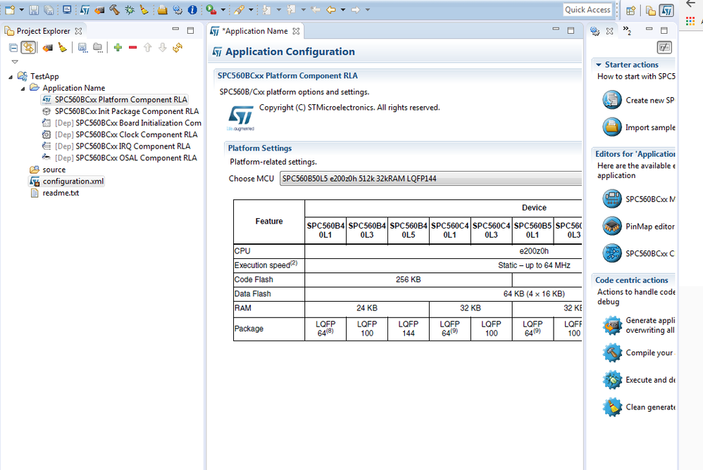

Hello Matthew ,
it is not a bug , you have forgotten to include Init Meta Component which contains Board init , Clock Component , IRQ Component and OSAL Component.
(Cf Screenshot)
Do not forget to save your configuration file.
