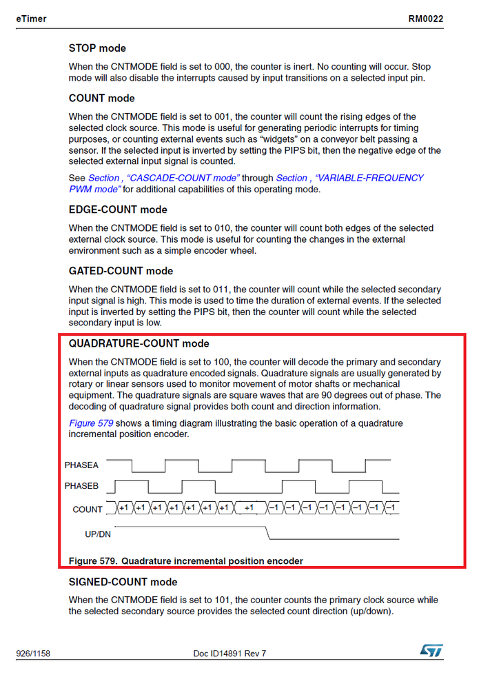

i recommend you to use eTimer (Cf Screenshot)
There is some examples how to initialize this IP (eTimer)
SPC560Pxx_RLA PWM-ICU Test Application for Discovery
Best regards
Erwan

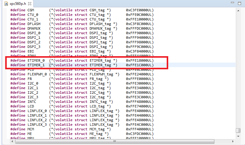

I have read about the eTimers in 'RM0022' and also tried to figure out and understand how the
example works.But where can I access to set all the eTimerst parameters and registers described in 'RM0022'?
The only eTimer parameters I seem to find in SPCStudio is 'Capture mode, HI/LO', 'clock f' and 'call back function names'?
/ Chris

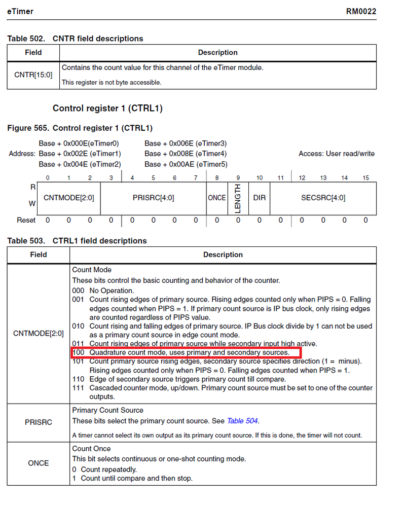

Hello Chris ,
SPC560Pxx_RLA PWM-ICU Test Application for Discovery is just an example.
For Quadrature-Count mode, you need to redevelop :
you need to set correctly the PIN
Enable the PCTL associated for eTime
set the registers to configure your Capture unit
You can access to the registers by this file cf RM022
Best Regards
