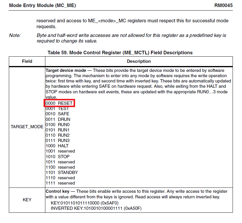

Hi.
How can i generate a software reset for A ‘functional’ reset source with SPC560D, I want to make a reset in bootloader.
This discussion has been locked for participation. If you have a question, please start a new topic in order to ask your question
Erwan YVIN
Posted on November 28, 2017 at 09:30
Hello Run Zhou,
you have to update ME_MCTL register
 // Transition to Reset
 MC_ME.MCTL.R = 0x00005AF0; //Functional reset Mode & Key
 MC_ME.MCTL.R = 0x0000A50F; //Functional reset Mode & Key�?�?�?
Best regards
Erwan

Posted on November 28, 2017 at 09:50
I got it, thank you.
