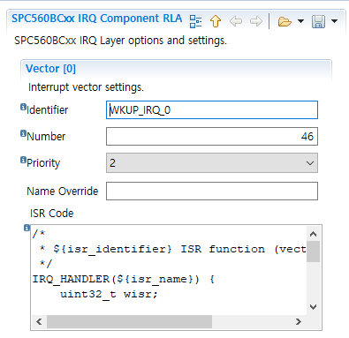

My target is SPC560B54L3 and using SPC5Studio with components
I saw SPC560BCxx IRQ example and followed into my application.
I would like to use PC11(WKUP5, WakeUp_IRQ_0)
and I checked WISR value is changing when I switch PC11 but ISR code doesn't run.
Here's my setting for WKUP
	SPCSetPeripheralClockMode(69, SPC5_ME_PCTL_RUN(2) | SPC5_ME_PCTL_LP(2));
	WKUP.WISR.R = 0xFFFFFFFFU;	// clear interrupt
	WKUP.WRER.R = 1 << 5;		// Enable WKUP5(PC11)
	WKUP.WIFEER.R = 1 << 5;		// Falling edge event WKUP5
	WKUP.WIFER.R = 1 << 5;		// Enable glitch filter WKUP5
Here's ISR setting
Also doesn't work if I change priority.
There is no more additional setting in ISR example.
Thanks for help
Best Regards

dongil.park
Sorry... my mistake
I missed setting IRER
