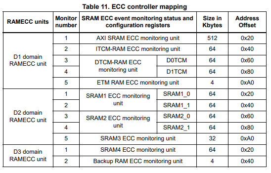

2. RAMECC monitors
The list of monitors vary depending on the STM32H7 series.
The STM32H74x/5x has one monitor for each RAM block in the MCU.
  • RAMECC1 controller has 5 monitors for D1
  • RAMECC2 controller has 5 monitors for D2
  • RAMECC3 controller has 2 monitors for D3
The detail is given in table 11 of the release manual.

  • RAMECC_MxCR  --  configuration
=> Address offset: 0x20 * x
=> x = ECC monitoring unit number
=> 0x52009000 + 0x20 * x                  with x = [1..5]
=> 0x52009020   Monitor 1 -  AXI SRAM ECC monitoring unit                           512Kb
=> 0x52009040   Monitor 2 -  ITCM-RAM ECC monitoring unit                            64kB
=> 0x52009060   Monitor 3 -  DTCM-RAM ECC monitoring unit for D0TCM        64Kb
=> 0x52009080   Monitor 4 -  DTCM-RAM ECC monitoring unit for D1TCM        64Kb
=> 0x520090a0   Monitor 5 -  ETM RAM ECC monitoring unit                                4Kb
