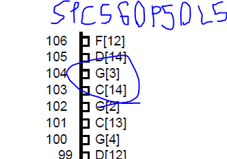

The specifications of the pins and ports are specified in the SPC560P50L5 microcontroller, but it is not clear in the SPC563M64L5 microcontroller. Please guide me.

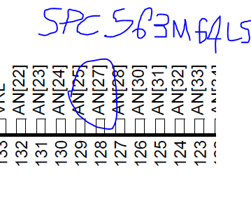

I don't understand what you are looking for exactly - the marked pins AN [25] and AN [27] are described in table 4, page 52 of the datasheet, e.g.:
  • AN[25]: Single Ended Analog Input
  • I/O Type: I (Input)
  • belongs to VDDA
  • Reset state: I (Input)
  • LQFP144: pin 129
  • LQFP176: pin 158
What do these pins have to do with the SPC560P50L5?

Very well, I mean more clearly. I want to know the port name and pin number of the SPC563M64L5 microcontroller. For example, to know where the port B or port E are, and also to know how many pins each port has and which microcontroller bases are the numbers of those pins.
There is no port B or port E, there are just GPIOs. The datasheet says at the bottom of table 6:
GPIO[n]:
Configurable general purpose I/O pins. Each GPIO input and output is separately controlled by an 8-bit input (GPDI) or output (GPDO) register. Additionally, each GPIO pins is configured using a dedicated SIU_PCR register.
The GPIO pins are generally multiplexed with other I/O pin functions.
The registers GPDI and GPDO are described in the reference manual, sections 15.8.15 and 15.8.16.
Regards
/Peter
