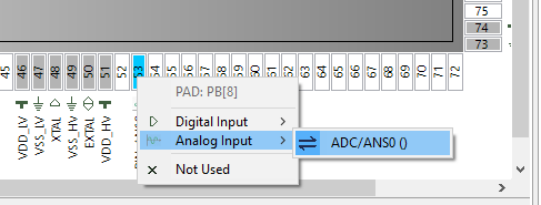

On spc560b MCU,
I use PE [7] as ADC input,
But why can't I read the analog quantity
There is no problem with the hardware
How to configure the software part
2 REPLIES 2
Jason Ren
0693W00000Lvs1BQAR.pngPE [7] on the pin configuration page, as shown in the figure
ODOUV.1
PE[7] is not an analog input
You can use PB[8] for example in Pin map wizard:
