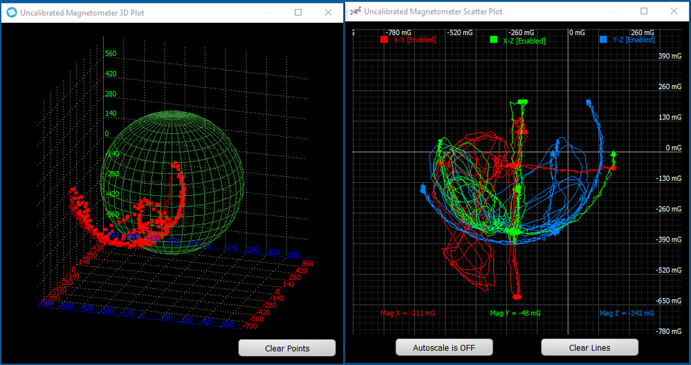

I have analyzed your datalog and I see the magnetometer did not reach the calibrated state.
You can check the scatter plot. The points should draw circle with center in [0,0], after calibration you will jump to the calibrated values.
From your datalog I see you didn't cover second half of the sphere (circle) with the movement.

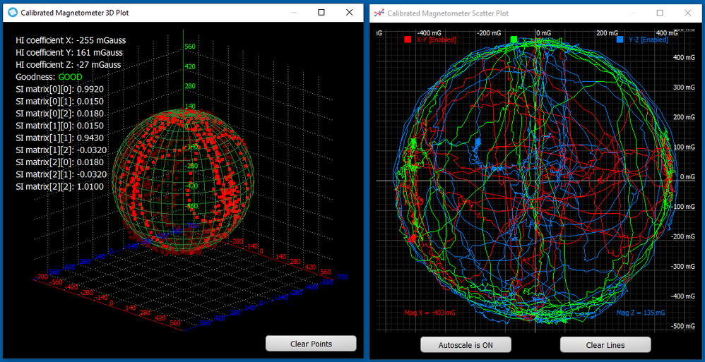

This is example of well calibrated magnetometer.
You can try the magnetometer calibration process using MagnetometerCalibration application in X-CUBE-MEMS1.

I did it again and this is the data log. After calibration, when I rotate along x axis there is a rotation along y axis (about -180°) for some seconds and then it return to 0°.
