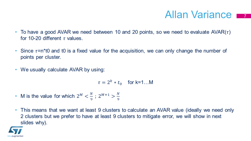

What's the usual measurement time/data points required to do allan variance on an IMU sensor?

Hi @KJ.2ose​ ,
I can share you our prescription in terms of Allan variance calculation:
0693W00000NqmAZQAZ.pngThis should help you about the calculation for the Allan variance.
If my reply answered your question, please click on Select as Best at the bottom of this post. This will help other users with the same issue to find the answer faster.
