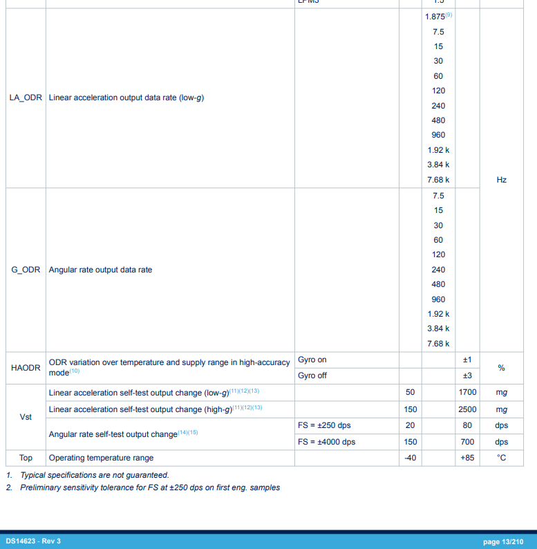

The available data rates are in the datasheet:
https://www.st.com/resource/en/datasheet/lsm6dsv320x.pdf#page=13
The data rate = sampling rate effectively defines the bandwidth.

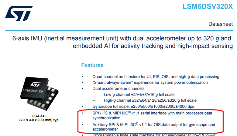

The available interfaces are defined in the datasheet:
4 REPLIES 4
Andrew Neil
Full product specifications, datasheet, application notes & other supporting information, evaluation tools, etc can be found on the Product Page:
https://www.st.com/en/mems-and-sensors/lsm6dsv320x.html

Also will sensor integrate with CAN?
