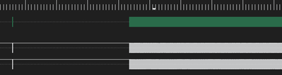

After I configure these, it works fine until I tap the sensor and I can see ENDLESS ibi on logic analyzer.
ENTDAA and some of the command
command set and endless ibi
ibi content:
During the endless IBI, I cannot send any command like read TAP source or reset sensor.
Am I doing anything wrong? Thanks

If I disable the IBI payload on master side, I got this
SDA always low.
