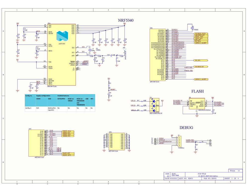

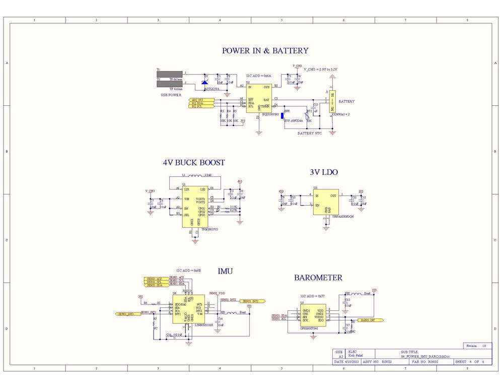

We have used LSM6DSOX with nrf5340 in our hardware. Making the CS high via nordic SoC does not detect the LSM6dso. What may be the issue? Is the schematic okay?

Really not sure you're going to get much support on this.
Description of the problem isn't helping.
How's it wired to the NRF5340
What interface are you using? SPI, I2C?
What's P-05 in this context.
Show code
Show schematic
plawat
Here is the schematics. Po5 is the GIPO pin of nrf5340. We make this pin High to find the LSM6DSOX in I2C mode.
