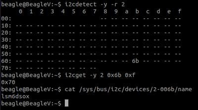

Do you see the sensors on the i2c bus using i2c-tools (like i2cdetect, i2cdump, i2cget and i2cset)?
Something like this:
# i2cdetect -y 2
@Federica Bossi
yes i was able to see the sensor connected at the bus and was able to see that the sensor names mentioned in the dtb file was reflected in devices of i2c device.
but im not able to get the device in /sys/bus/iio/devices/ dir.
