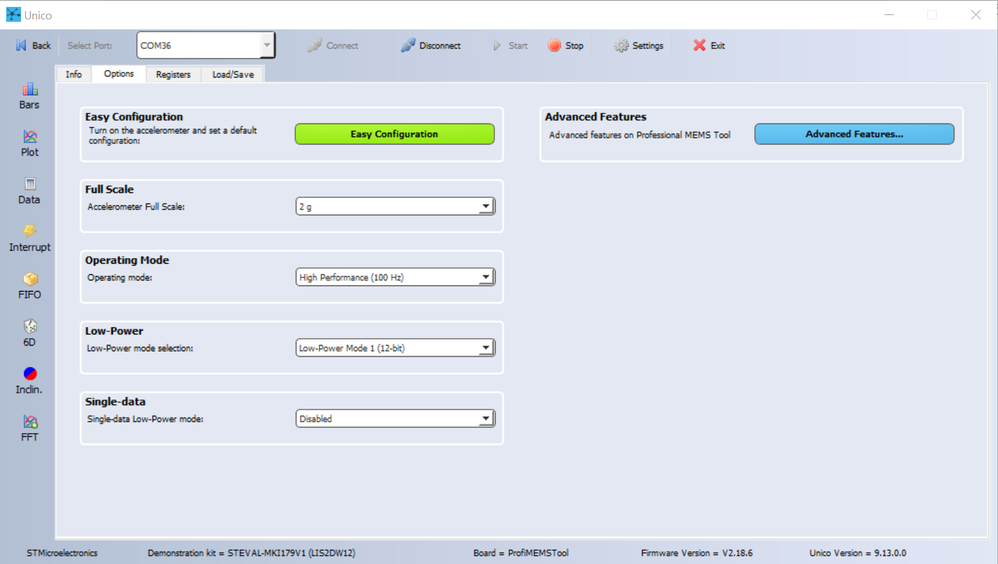

Using the STEVAL-MKI109V3 with MKI179V1 accelerometer daugther board, connected to PC via USB
Lauching Unico GUI 9.13.0.0 and selecting a device -> communication error probably due to an unappropriate driver
What driver is to be used with Windows 10?

BUT, it didn't work , the port was enumeraed in Device Manager but no way to communicate....

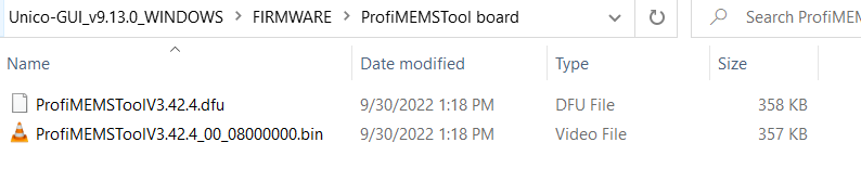

coming back to FW version: I have V2.18.6 coming with download of GUI UNICO V9.13.0.0.
Is it correct?
In the UM1049 I read 3.30.0

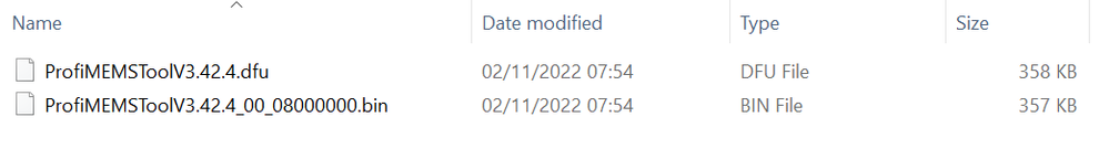

‎2022-11-03 9:07 AM
Hi @LCari.1​ ,
the associated Unico FW should be the v 3.42.4 version
-Eleon
‎2022-11-03 9:12 AM
Yes , I have the V3.42.4

The interface has many less tabs and options than the on described in the UM1049
