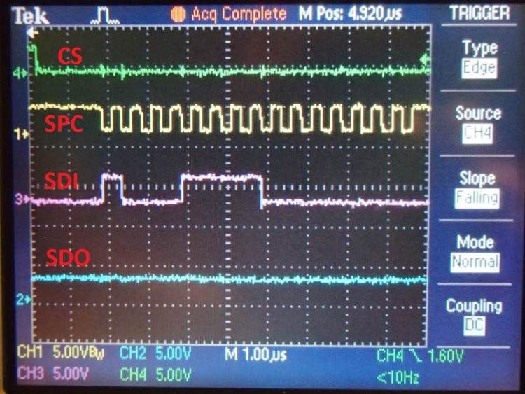

Mikhail Polyakov
Posted on September 30, 2013 at 23:18
I have the problem with LIS3DH in SPI mode too.
Whichever register I try to read, the answer of LIS3DH is 0xFF.
The line SDO  is everytime in high state.
Here is a picture with try to read register WHO_AM_I  on adress 0x0F
What am i do wrong ?
Mikhail Polyakov
Posted on October 03, 2013 at 08:28
The problem was in bed soldering of IC.  The same way on two board, that led me astray.
