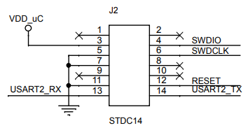

Hi @Chandrashekar C​ ,
I'm wondering if the SWO pin, required for Serial Wire Viewer (SWV) trace, has been wired on STWINKT1 board... This is an optional pin, as declared by the ST LINK V3 user manual.
The schematic of the application board doesn't seem to include that pin... this may cause the miscommunication.
-Eleon

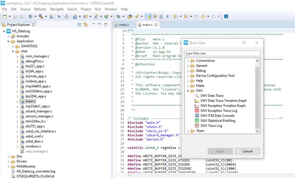

I find the SWV comsol in Window - Short wiew - other - SWV, and then select for example the SWV Data Trace.
For a tutorial on how to set up the proper variables to be monitored, you can refer to this video.
-Eleon

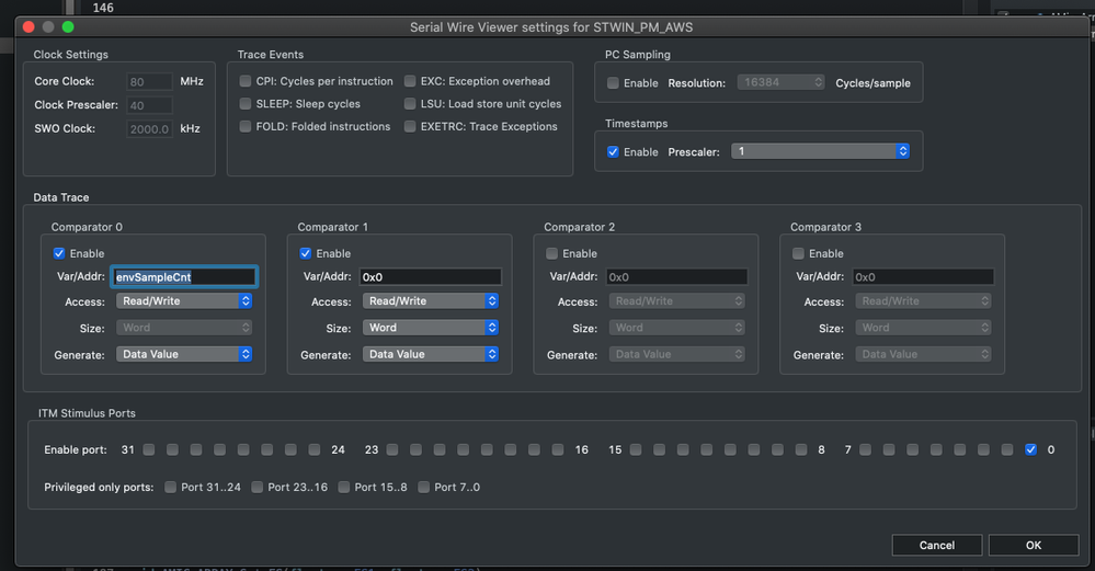

Hi @Eleon BORLINI​,
Thanks for your kind response.
I have tried all these and I have also referred to the video you have mentioned in the previous message.

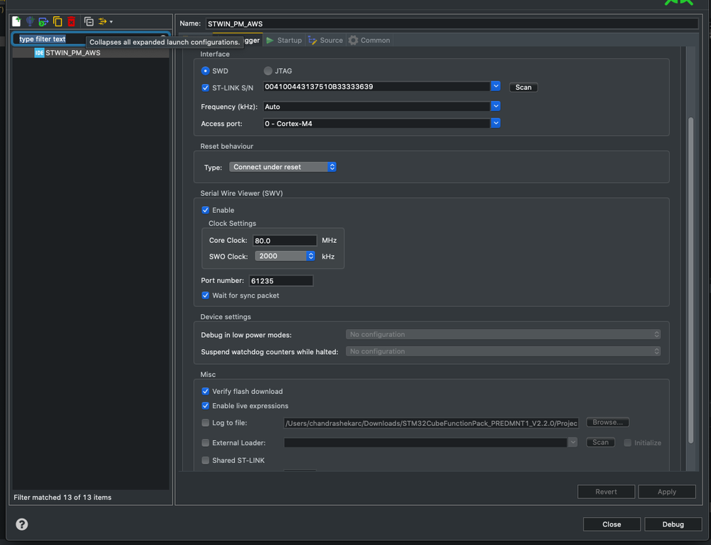

I am trying use SVW console for STWIN_PM_AWS application, instead of terminal, I wan to re-direct all the messages to SVW console.
Here is my debugger configuration
I did changed the puts function as following
  * @brief  Retargets the C library printf function to the USART.
  * @param  None
  * @retval None
PUTCHAR_PROTOTYPE
  /* Place your implementation of fputc here */
  ITM_SendChar(ch);
  return ch;
Just wanted to know if I need to enable any macro? or am I doing anything wrong here?
Kind Regards
Chandrashekar C
