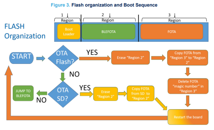

I have a big problem with my STWINKT1B. I wanted to load another binary file to it but there was no room left. So in STM32CubeProgrammer, I erased the flash memory. Now the green and orange LEDs do not light up and I can't access the board through TeraTerm and ST-LINK !
Hope that someone can provide some help,
Thanks !

It may be an issue related to the bootloader section of the code: you might have overwritten it, so I suggest you to restore it, using the file with the bootloader, in the FP-IND-PREDMNT1 firmware function pack.
The procedure is described in the UM2566 user manual, page 7 (STM32CubeProgrammer + DFU mode).
0693W00000CzgaLQAR.pngFor example, you can use the STM32L4R9ZI-STWIN_PredictiveMaintenance_BL_v2.3.0.bin, which is the factory firmware of the STWINKT1B, that you can find in \Projects\STM32L4R9ZI-STWIN\Demonstrations\Predictive_Maintenance_BLE\Binary folder.

Hi Eleon,
The next morning after I had the problem, the board worked again. I suspect I indeed used the bootloader from FP-IND-PREDMNT1.
Thanks for your help,
Benoît
