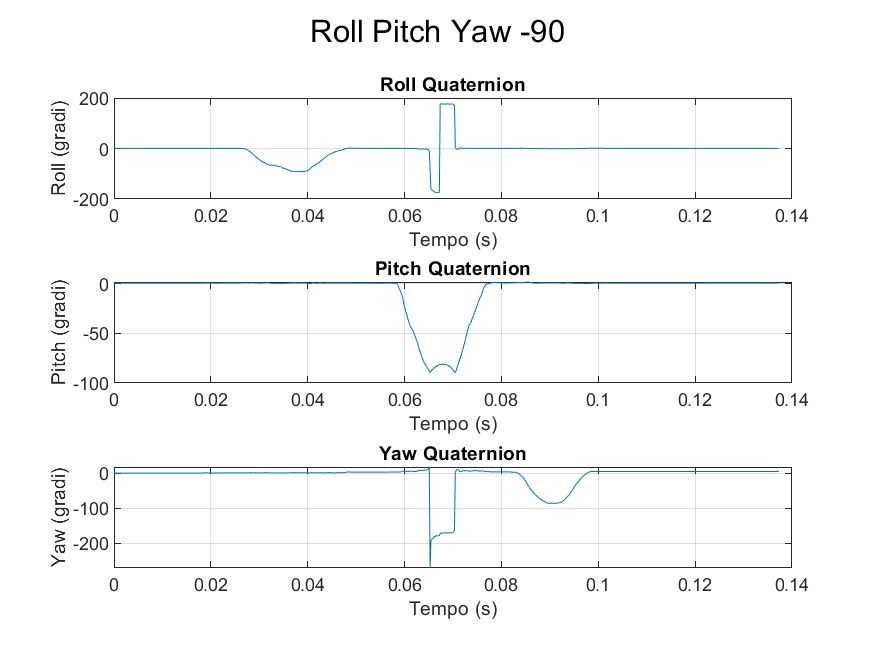

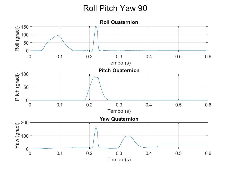

The commands I used to get Euler angles from quaternions in Matlab are the following:
"q=quaternion(W_values,X_values,Y_values,Z_values);
angles=eulerd(q,'ZYX','frame');
roll_eulerd=angles(:,3);
pitch_eulerd=angles(:,2);
yaw_eulerd=angles(:,1);
yaw_eulerd = yaw_eulerd - yaw_eulerd(1);"

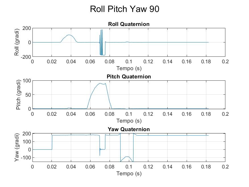

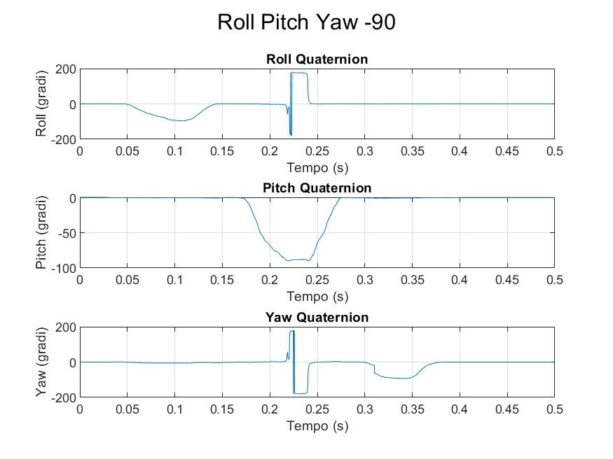

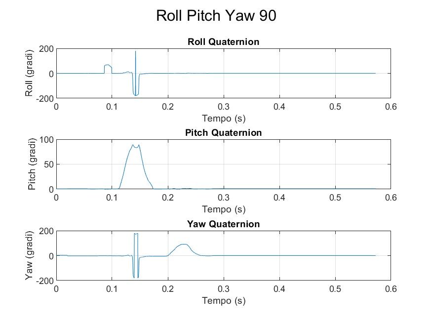

In the first acquisition I performed a roll:+90, pitch:+90, yaw:+90 rotation and in the second acquisition I performed a roll:-90, pitch:-90, yaw:-90 rotation and I get the attached graphs.
The pitch angle corresponds to the rotations made but the Roll angle varies even when it varies pitch angle and the Yaw angle instead always has a strange trend. I tried changing the ODR from 30Hz to 120Hz and also tested the HAODR but the results don't change much.
ODR: 120 Hz
ODR: 120 Hz
HAODR
HAODR
I also encountered this problem when implementing the Motion FX 6x and Motion FX 9x libraries and getting quaternions as output.
Since for my project I need to obtain very precise angles that do not vary when there is rotation around a single axis, what can I do?

2024-11-11 12:08 AM
Hi @marti3110 ,
This is not a problem with the algorithm (neither SFLP nor MotionFX 6X / 9X), but with the representation of the output using Euler angles, which by nature suffer from the well-known ‘gimbal lock’ issue.
If you try SFLP with MEMS Studio which visualizes the outputs via a 3D model (rotated using the quaternion generated by the sensor), you will see that the algorithm works more than well and without jumps.
