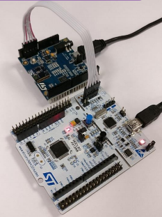

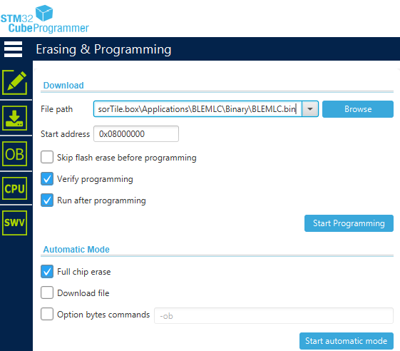

If you have an STLINK you can connect it to the Sensortile cradle and flash the ALLMEMS1 bin file (the one with the Bootloader) into the Sensortile L4 core.
0693W000005Bfj5QAC.png or
0693W000005BfkvQAC.pngWhen running the firmware on the STM32CubeProgrammer, you should first run the Full chip erase command so that the currently onboard firmware will be erased. Is the programmer able to detect your board (ST LINK configuration)?
-Eleon

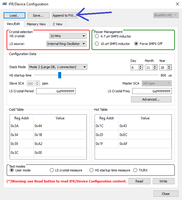

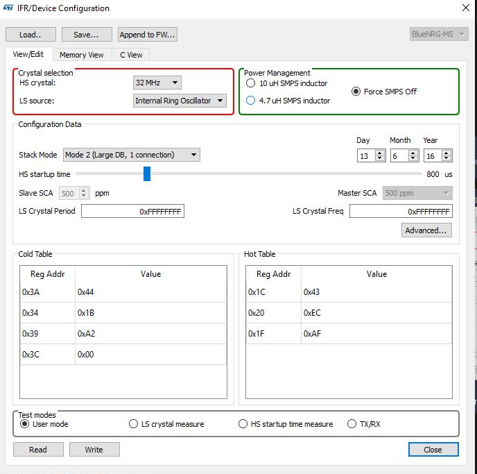

To overcome this issue, you can try with flashing the attached binary file on the STM32: this .bin will allow you to use the BlueNRG-GUI and to flash the BlueNRG. Please assure that the IFR parameters are set as shown below:
_legacyfs_online_stmicro_images_0693W000005CWaAQAW.pngLet me know you are able to fix the issue with these indications.
-Eleon
Thank you very much again for your support but unfortunately the SensorTile has not been resurrected.
1) I flashed the SensorTile with the file "SensorTile_BLE_Updater_VCP svn126.bin" that you have sent to me.
2) I launched BlueNRG GUI v4.0.0: in the combobox with the list of COM ports, I have found "COM22 (ST DK)", which is evidently the SensorTile connected to the PC.
3) I selected "Tools->IFR/Device Configuration...", then I have set the options as you suggested in your screenshot. Finally, I pressed "Append to FW..." button, I selected "Firmware->BlueNRG-MS_stack->bluenrg_7_3_Mode_2-32MHz-XO32K_4M.bin" and I saved it as "carlo.img", to be sure to not corrupt original file.

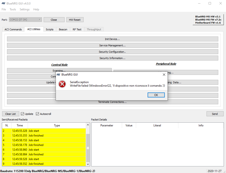

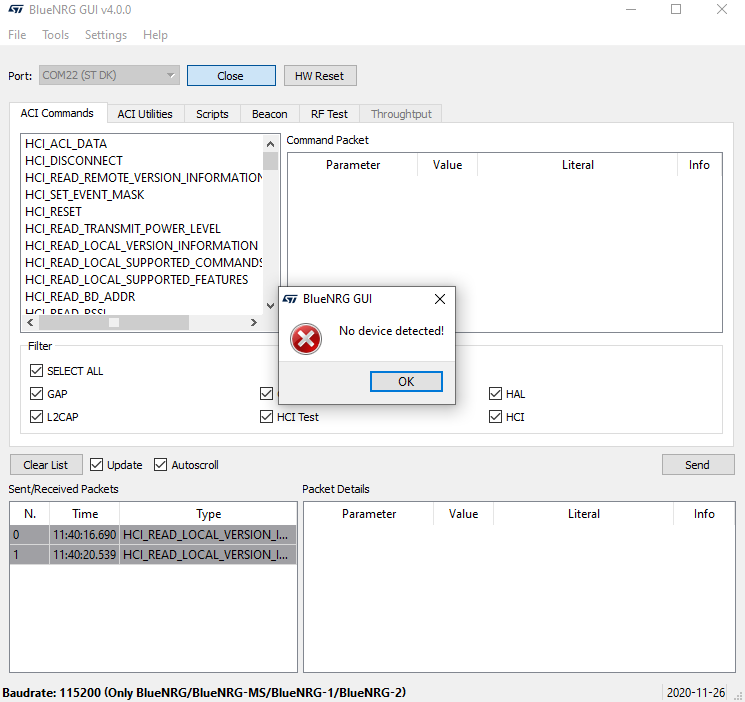

At this point, I pressed "Open" button on the main window and the software prints these errors:
0693W000005CtzwQAC.pngand then:

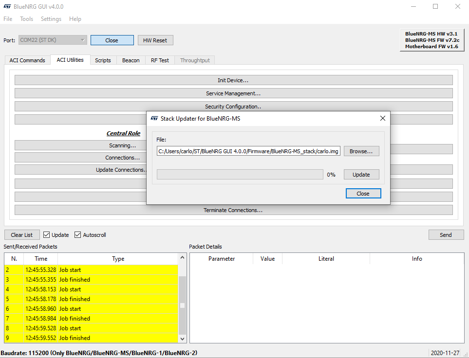

If I select from the menu "Tools->Stack updater...", I select "BlueNRG-MS" from the combobox, then it opens this dialog box and I select the "carlo.img" file that I created with your guidelines. If I press the "Update" button, nothing happens except that it prints these yellow messages inside the parent window:
"Job start"
"Job finished"
0693W000005Cu0kQAC.pngand an exception error is showed when I close that dialog box:
SerialException WriteFile failed (Windows error(22, "Il dispositivo non riconosce il comando"))
0693W000005Cu14QAC.pngNote, that italian sentence means "The device does not recognize the command" in english.

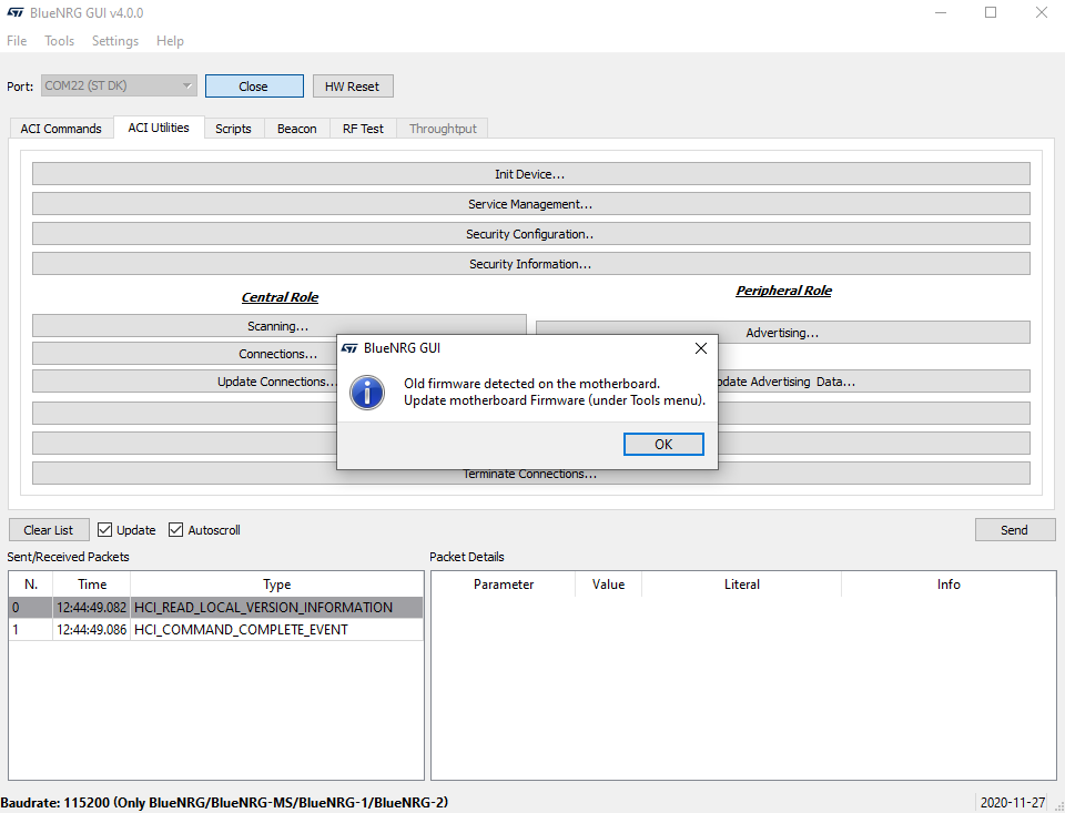

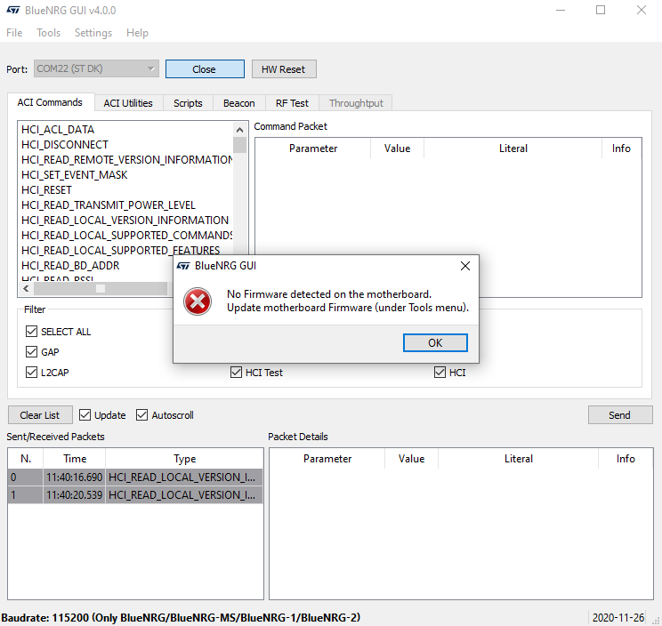

If I program the file "SensorTile_BLE_Updater_VCP svn126.bin" inside a new SensorTile, I'm getting this screen:
"Old firmware detected on the motherboard. Update motherboard firmware (under Tools menu)".
0693W000005Cu2MQAS.pngshowing that the firmware you sent me is actually working.
