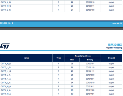

I'm using the STEVAL-MKI245KA development kit, trying to get the IMU readings with an AT-Mega through I2C. The I2C communication between the adapter board of the kit is working, but the IMU values recieved by the arduino are not updating. When I run the code to get the accelerometer and gyroscope values, the value is always 0 for all axes acc and gyro. (the reason I know the I2C is working is because when it wasn't working, the values were all -1, but when it does 'work' the values at all 0).
Here is a screenshot from the datasheet of the IMU with the registers of all the parameters:
And here is the code that I am using to access the values at these registers:

What am I doing wrong? My end goal is to read and use the IMU accel and gyro values for dead reckoning.
2024-08-30 02:36 AM
Hi @cloudymnms ,
Can you try to follow our official PID example on Github and let me know if you will be able to get the data? Thanks
