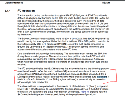

The IIS2DH supports auto increment on I2C, but, as mentioned in datasheet, the auto increment is based on the MSB bit of the subaddress:

Hi @engineer42 ,
