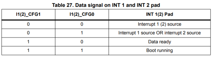

Hi @PGoud​ ,
is it only the DRDY interrupt that is not working in your application, or also other interrupts (the ones generated from mechanical events)?
I suppose you already tried configuring the CTRL_REG3 [interrupt CTRL register] (22h) for the Data Ready routed on INT1(2) pad (datasheet, p.27):
0693W000008z5vaQAA.pngYou could try to enable the LIR1 bit and see if the interrupt is working at leas in latched mode.
You can also try to set 01h in the INT1_DURATION (33h) register.
-Eleon
PGoud
Hello Eleon,
Basically, DATAready interrupt works well for me, no problem about configuring it, it's ok.
My exact problem is that do not success in making it working as a "Free" "Pulses interrupt".
I mean I would like to see the INT1 line making "ON/OFF/ON/OFF/ON... without needing to "read acceleration" after each edge. I already tried the "Pulse" configuration" and even set the INT1 duration to 1 or 0 but It seems to be always mandatory to "Read accelerations" to "release" the current state of INT1 Line ...
So, can you tell me if there is a way to let DataReady interrupts run in kind of "free run" (one pulse after each sample) without any more action on the H3LIS331DL after it's configuration ? ... Maybe it's not possible ...
