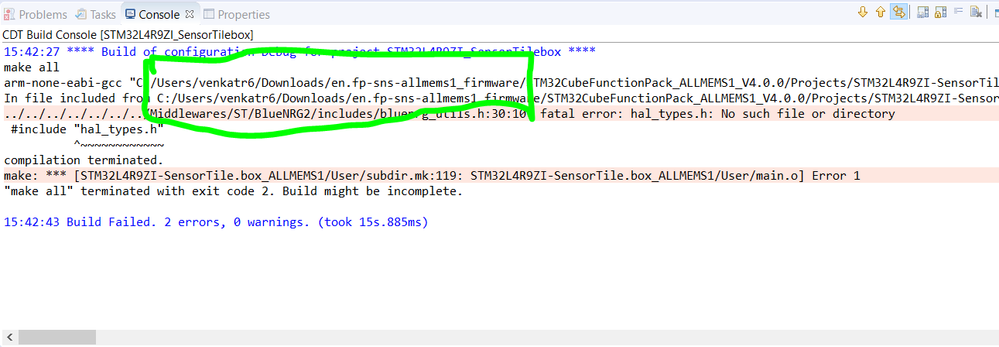

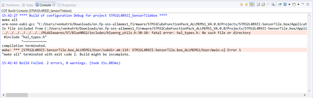

Hello all,
I recently got the sensortile.box and was trying to play with the all mems function pack (FP-SNS-ALLMEMS1) but had trouble building the project. I have added an image of the error that I get when I try to build the project.
I was able to flash the BLE bin file which was provided with the function pack and it works just fine with the iOS app. However I wanted to play around with the main code and perhaps add new functions to it. In order to do this I would need to be able to build the project.
Any help on how to proceed with this issue would be much appreciated.
Thanks in advance,
VRao.1

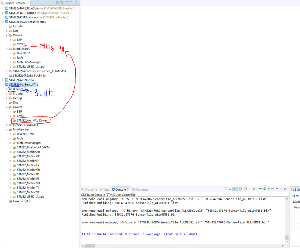

Hi @VRao.1​ , the issue could be related to the path length of the project repository. Please try to save the project directly in c:/ … and then try again to build the project.
Regards
Hello @Eleon BORLINI​ ,
Thank you for the response. I tried moving the project closer to the C:/.. directory but I got the same error again. I tried building one of the other provided projects, (the one for the Sensortile) and didn't receive any errors. So i tried looking at the drivers and middleware for the two projects to try and determine what the issue might be.
In doing so I noticed that the Sensortile Box is missing the STM32L4xx_HAL_Driver folder in the Drivers section, this maybe one potential reason for the error
