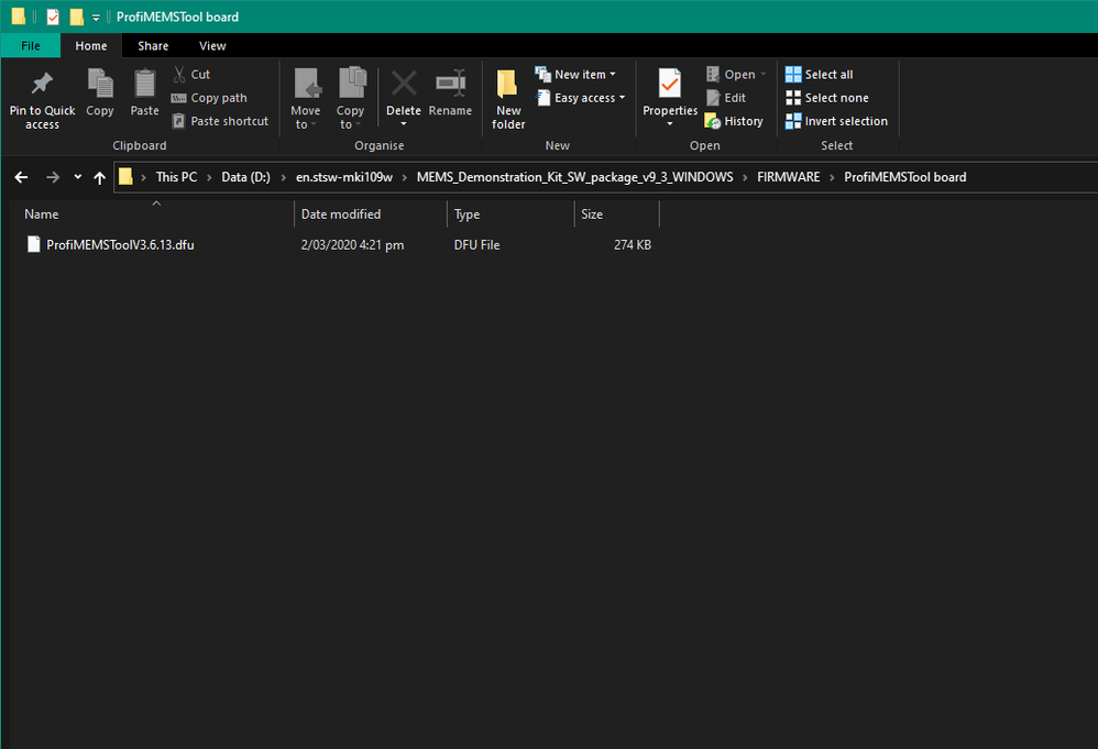

Unico v9.3.0.0 missing 'ProfiMEMSToolV3.6.13.bin' file?
SBrow
I downloaded the latest Unico (en.stsw-mki109w.zip) and unpacked it. Since I'm running Windows, I followed the instructions to install STM32CubeProgrammer. But when I try update the firmware, there is no .bin file in the archive. It only contains a .dfu file. Where can I get this firmware .bin file?

Eleon BORLINI
Hi @SBrow​ , please find attached the ProfiMEMSToolv3.6.13.bin file. You can also use the Dfu file manager application from ST to extract the .bin file from the .dfu file. Regards
