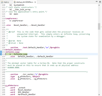

Going back to the issue, I am quite stuck with the project I intend to do. I have downloaded the firmware example (on the link attached on the previous post) and have been trying to merge the projects BLE-SampleApp (sends environmental sensor's data through BLE) and Serial_DataLog (sends motion sensor's data throught serial port).
First I tried attaching Serial-DataLog's files to the BLE-SampleApp but a lot of error ocurred when I tried using the motion sensors functions. I can't remember exactly what the errors were, but suddenly a lot of them appeared. I can remember that a lot of the errors were due to multiple definitions, when the functions were declared only once (the errors didn't have a lot of sense).
Since I stayed stuck in that project a lot of time, I have tried doing something similar but the other way around: trying to introduce the BLE files and functions into the Serial-DataLog application. I had some errors because there were lots of files that I had to attach, but I have managed to build the project without errors. What I have done is leave the original project the same but introducing the BLE initializacion functions.
The problem is that now that I initialize the BLE, the task manager fails and the program goes to an infinite loop, and I don't understand why or how I can introduce the BLE communication...
The functions I use to initialize the BLE are Init_BlueNRG_Stack() and Init_BlueNRG_Custom_Services(), and the program stays stuck here:
Does anyboda have a solution? It is supposed to be simple changing the example codes and adapting it to your interests, but I don't see it simple at all. I have been reading lots of documentation but I only read documents refering to the exaples given, and not on how to modify the examples...
Any solution will be much appreciated because I can't think of more solutions...
