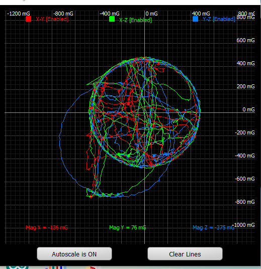

I have a compass program using an LSM9DS1 chip and the STMicro's CUBE-MEMS compass library. This is working.
I switched from the LSM9DS1 to the LISM2MDL. I am using the same program. This does not work. It appears the STMicro CUBE-MEMS library breaks (never creates good compensation values) because the LISM2MDL magnetometer values are so far out of alignment.

To further make my point, I decided to try and break my working LSM9DS1 compass program. Specifically, I am going to subtract 25 from the LSM9DS1 raw X value to simulate the bad LIS2MDL raw X value.
This change does appear to break the STMicro CUBE-MEMS Compass Library! I am testing the code using STMicro's Unucleo-GUI's Scatter Plot and Compass features. I can no longer get the compass to work. I turn the LSM9DS1 360 degrees and the simulated compass on the screen only wiggles between ~150 to ~210 degrees. And the Scatter Plot is clearly creating 3 distinctly separate balls. Ideally, all 3 colors (x-y, x-z & y-z) would form a single ball after enough data is collected to do a proper calibration of the magnetometer.
Do all STMicro LIS2MDL magnetometers behave this badly?

I have re-written my LIS2MDL code to "pre calibrate" the raw data before submitting it to the STMicro's CUBE-MEMS function "MotionMC_Update()".
I have captured the minimum and maximum values I am creating from the raw LIS2MDL magnetometer values:
Max X: 48
Min X: -54
Max Y: 46
Min Y: -51
Max Z: 49
Min Z: -51
Note, my "normalization" code is tuned for this particular LIS2MDL chip and testing location. (That is, my "normalizatoin" code is not adapting as data is read from the LIS2MDL. The offset and magnitude adjustment values are fixed so as not to confuse the Middle Ware or cloud testing results.). The Middle Ware still does not appear to be calibrating properly. The (Unuclio-GUI) scatter plot initially appears as 3 separate balls not centered on the origin of the graph - then jumped (assume this was the Middle Ware making the calibration) creating 3 new separate balls not centered on the origin. If I could make any generalization, I would say the 3 new balls were simply arrived at by rotating the center of each ball around the origin of the plot 180 degrees. (That is, their positions were flipped left to right and up to down.) The Unuclio-GUI virtual compass was still not working. Only moving between about 150 to 210 degrees fro a full rotation of the magnetometer.

Rstua.1
Senior
I noticed there was an error in the code. I used an accelerometer HAL function to normalize the raw magnetometer value to Gauss. However, the LIS2MDL is fixed at 1.5 mG per unit of measure. So instead I now divide by 1.5 to get mG:
		// Convert raw magnetometer value to milligauss.
		// Sensitivity of magnetometer for LIS2MDL is 1.5mgauss/LSB, sensitivity .
//		magnetic_field_mgauss[0] = lsm6dso_from_fs4_to_mg(data_raw_magnetic_field.i16bit[0]);
//		magnetic_field_mgauss[1] = lsm6dso_from_fs4_to_mg(data_raw_magnetic_field.i16bit[1]);
//		magnetic_field_mgauss[2] = lsm6dso_from_fs4_to_mg(data_raw_magnetic_field.i16bit[2]);
		magnetic_field_mgauss[0] = (data_raw_magnetic_field.i16bit[0] / 1.5);
		magnetic_field_mgauss[1] = (data_raw_magnetic_field.i16bit[1] / 1.5);
		magnetic_field_mgauss[2] = (data_raw_magnetic_field.i16bit[2] / 1.5);
...Unfortunately, this did not fix the problem.
Miroslav BATEK
You can use function lis2mdl_from_lsb_to_mgauss to convert raw data to mgauss.
This function multiply the value by 1.5 so I think your code is wrong.
float_t lis2mdl_from_lsb_to_mgauss(int16_t lsb)
  return ((float_t)lsb * 1.5f);
Ah! That Worked!
...can't believe I wasn't able to get here empirically (print out the values and adjust them until they are all in an expected range).
-thanks!
