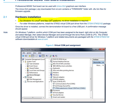

Unfortunately, that tutorial is five years old and a few things have changed in the meantime.
Now you can follow the steps reported in this user manual in section 2.2.

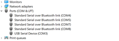

Hello @Federica Bossi ,
I followed the document you mentioned. However, the issue is that I don't see ST Virtual Port when I connect to my device. I upgrade the firmware through STM32CubeProgrammer. What is the reason behind this issue?
