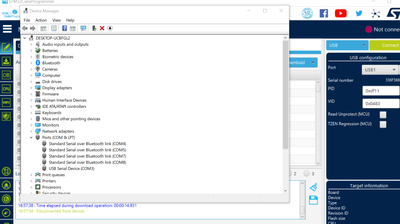

FKara.3
October 11, 2023
Hello @Eleon BORLINI ,
I followed the tutorial, but I still don't see the ST Virtual Port in the device manager. So, I get an error message which says "the adapter has not been recognized" in UNICO.
AV B.1
AV B.1Author
November 17, 2021
Hi @Eleon BORLINI​ ,
Thank you so much. It worked !! :)​
