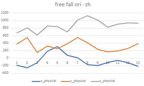

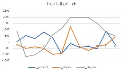

Hello We are working with accelerometer LIS2DW12.
we did tests on the different movements of the accelerometer and the graphs we see (the graphs were made with the x_physical y_physical z_physical values). However we see graphs that are not as we expected;
when we look at a 'free fall' movement we expect to see all axis intersect in value 0, however it is not the case.
For example:
  1. 0693W00000BbSy9QAF.jpgin this image we see free fall when the orientation bit raised on zh (meaning the fall was on zl), but I do not see intersection of all axis ( Z is not even close) and I do not see intersection on 0 - x&y intersect on ~300 . Please explain this.

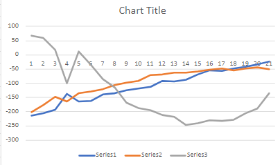

  2. 0693W00000BbT1GQAV.jpghere we do see intersection , however it is around value ~360 and not 0. Please explain why we see it.

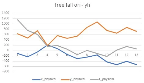

More images :

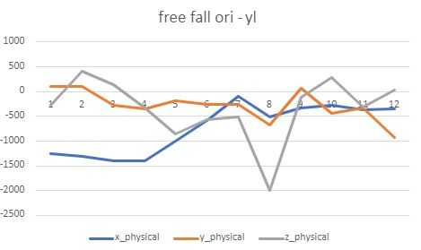

0693W00000BbT2OQAV.jpghere we see that the intersection is ~200

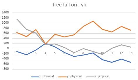

0693W00000BbT2iQAF.jpghere we see that the intersection is ~250 (at 31)

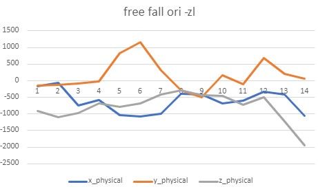

0693W00000BbT2nQAF.jpghere we don't see intersection and the values are not as expected from free fall.
Please help me understand our results.

Hi @Msaga.1​ ,
it could be that the accelerometer has a residual offset, and I'm referring to the plots where you are seeing the intersection among the axes.
I suggest you to first check this residual in a steady condition, i.e. with the device is flat on the ground, with z axis pointing to the sky. In particular, you can tune the X_OFS_USR (3Ch), Y_OFS_USR and (3Dh), Z_OFS_USR (3Eh) registers (see datasheet p. 55) to minimize the offset value.
By the way, is the device in free fall condition during all the plotted acquisition, of just in a small timeframe? Which is the time scale along x axis (if seconds, it's difficult to capture a (fast) free fall in rms value)?
I suggest you in any case alto to check the C example for the free fall app on Github --> lis2dw12_free_fall.c, especially for a double check of the device initialization:

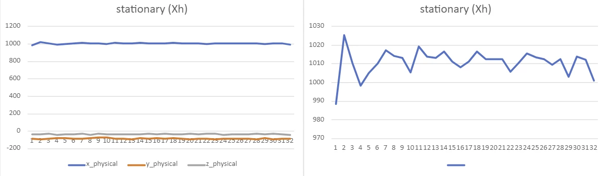

Msaga.1
Msaga.1Author
June 22, 2021

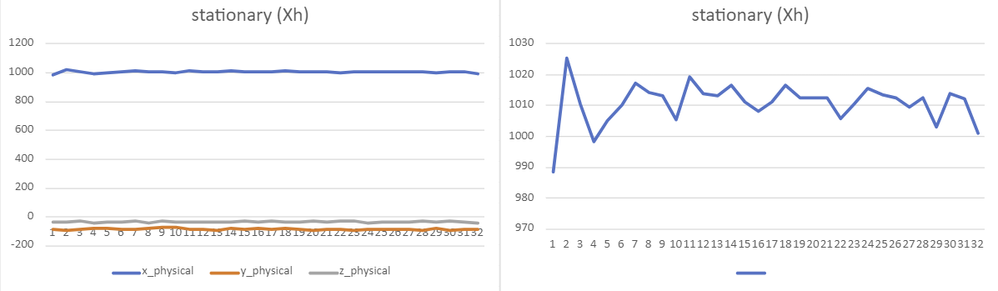

Hi @Eleon BORLINI​ , thank you for your answer,
About checking  this residual in a steady condition I am attaching the graphs for the steady condition:
0693W00000BbdNvQAJ.pngthis is an example on one orientation bit, on all orientation we get the same graph +-g on the appropriate axis. (dont pay any attention to the right graph)
The device in free fall condition during a small timeframe, we want to see the movement graph if we 'drop it'.
What is the example you said will do? what do I expect to see?
thank you
Eleon BORLINI
June 23, 2021
Hi @Msaga.1​ ,
since the free fall event is very fast, in order to see the movement graph you have to acquire -for example- at 200Hz as shown in the C example above.
Which data rate speed are you using so far?
By the way, in the stationary graph I see there is a residual offset especially on Y axis, that you can compensate writing the average value in the Y_OFS_USR and (3Dh) register.
The example above shows you how to configure the embedded free fall detection feature in the device, showing you especially how to characterize the free fall event in terms of duration (06h value = 6 * 1/ODR) and threshold (3h = 10LSB), in the FREE_FALL (36h) register.
Are you exploiting this feature?
-Eleon

Eleon BORLINI
July 1, 2021
Hi @Msaga.1​ ,
1) The threshold is needed for the internal state machine (the free fall block) to recognize how much close to the 0g level the free fall event shall be. In the graph you are showing, all the axis are close to 0g and the device should correctly detect the free fall with a proper setting of the threshold. This could be tuned trying multiple drops and checking the best threshold for your application.
2) Do you have problems to detect the free fall (axis below defined threshold) also with higher ODRs? 3 points should be enough but aren't too many...
By the way, enabling the low noise filter should also affect the noise performances in LP, according to the Table 11 in the datasheet, p.15.
3) + I have written to the registers however nothing has changed, can you explain it to me?
A spurious offset due to soldering, or the specific application setup could affect the correctness of the acceleration zero level. But are you writing values in the registers without seeing any variation of the data, at least in the steady state?
-Eleon

Msaga.1
Msaga.1Author
July 14, 2021
What I want is to look at the graphs I make from the x,y,z values and 'see' the free fall (x number of points with the value 0,0,0 - x depending on the hight of the free fall)
so i dont care much for the interrupts.
>>in order to avoid spurious effects coming from a single device, did you have the possibility to test another LIS2DW12?
I tested this on multiple devices but unfortunately the same result.
