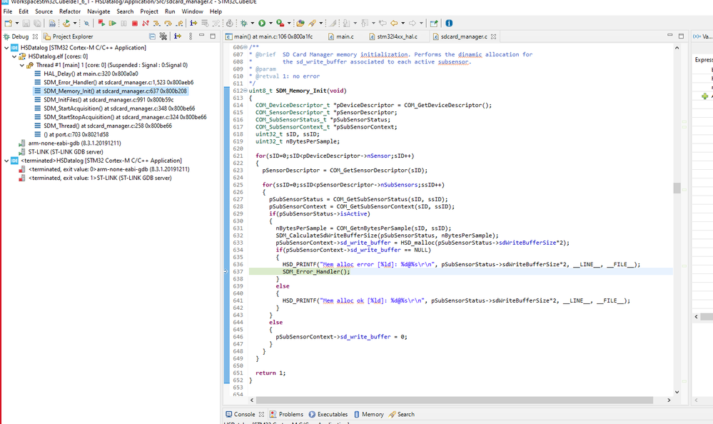

On the STWIN SensorTile Wireless Industrial Node, the standard en.fp-sns-datalog1_v1.2.0 firmware behaves differently if using the binary, rather than compiling the code in the STM32Cube IDE.
LWeir.775
When I compile the code in the IDE and run it (with the acquisition json file set to activate for 5s, then idle for 10s, and repeat) It activates correctly the first time. However, when coming out of idle the second time, it produces an SD card error (see below). Any ideas why I wouldn't be getting this with the precompiled binary, but do get it with the cube project files?0693W00000DmSBZQA3.png

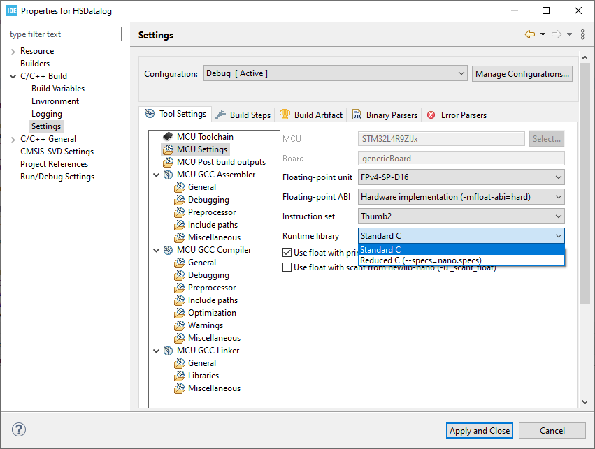

Hi @LWeir.775​ ,
It is an issue related to the C standard library that occurs only in the CubeIDE, independent from the automatic mode.
The precompiled .bin file the issue doesn't appear since it has been compiled in IAR.
You can solve the issue by selecting the correct library in the Project options, as shown in the picture below:
In the FP-SNS-DATALOG1 v1.2.0 the "Reduced C" option is wrongly selected.
As a side note, please consider the following change in the sdcard_manager.h code:
#define SDM_MIN_BUFFER_SIZE    1024 (in the original code it was 512)
