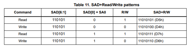

@atamby187 wrote:
The problem was with the i2c address of the Adafuit IMU which is 0xD4 (0x6A << 1) and not 0x6A as seen on Adafruit website.
An I2C address is just 7 bits, so Adafruit are correct to say that the I2C address is 0x6A = 110 1010
The value 0xD4 is made up of the address plus the R/W bit1101 010= 0xD4
This is a frequent cause of confusion:
https://www.avrfreaks.net/s/topic/a5C3l000000UXMPEA4/t142031?comment=P-1150738#:~:text=The%20discrepancy%20between%20talking%20of%20I2C%20addresses%20as%207%20or%208%20bits%20is%20very%20common%20indeed%20in%20software%2C%20tutorials%2C%20articles%2C%20and%20device%20datasheets.
As shown in the ST datasheet, the value 0xD4 is the "SAD+R/W" - ie, Slave ADdress plus the R/W bit:
