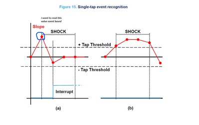

We are using LSM6DSO32 accelerometer.
I configured Single tap shock event on interrupt.
Interrupt is getting generated when there is shock
i want to read peak value of that shock.
how to read acceleration data OUTX_H_A, OUTX_L_A, OUTY_H_A, OUTY_L_A, OUTZ_H_A and OUTZ_L_A when there is shock ?
I want to read peak value of G when there is shock

Hi @MSelv.3 ,
You can read the output continuously (from register 22h to 2Dh) and in post processing get the maximum value.
