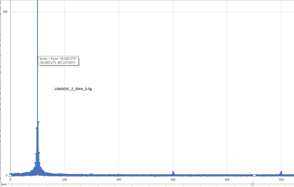

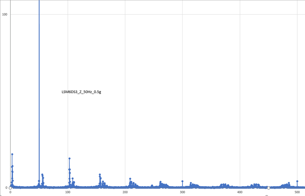

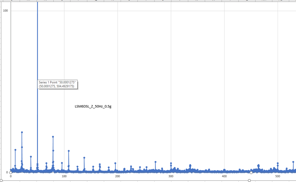

I have three accelerometers and the circuit is designed according to the datasheet.
I have collected the data of three kinds of accelerometers with the vibration test-bed.
The sampling frequency of the accelerometers is all set to 800 Hz, placed horizontally, and the z-axis is perpendicular to the horizon.
The vibration test-bed is set as the vibration frequency 50Hz, and the vibration amplitude is 0.5g. After that, I analyzed the z-axis data of the three accelerometers with FFT, and found that the noise of lsm303c is smaller than that of the other two accelerometers.
Is that possible?

    April 8, 2020
