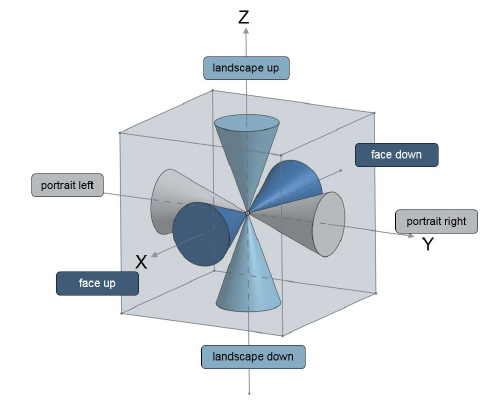

Thank you for your answer. I solved the questions above, but I have another problem with the 6D position detection.
First of all my configuration:
  • All three Axis enabled, Low-Power mode 10Hz (Register 0x20=0x2F)
  • BDU activated, +-2g FS (Register 0x23=0x80)
  • AOI1 on INT1 PIN (Register 0x22=0x40)
  • INT1 Treshhold 500mg (Register 0x32=0x20)
  • INT1 Time 0s (Register 0x33=0x00)
  • INT1 6D position detection, z high & low activated (Register 0x30=0xF0)
With this configuration the PIN INT1 is high, when the value of the z-axis is above about 900mg or below -900 mg, but the treshhold should be 500mg.
Have I made a mistake in the configuration?
Is there a calulation, to get the angle with the configured treshhold?
Posted on March 12, 2018 at 15:57
The angle and the threshold have following relation    =    × sin (  ) where A is acceleration in g, g is Earth?s gravity (1g) and ? is angle in degrees.
So for your value 0x20 (500mg) the interrupt is generated up to 30° deviation from landscape up or landscape down orientations (
Register 0x30=0xF0)
To detect these two orientations the values in X and Y axis is compared with the threshold. You can check the INT1 pin is high only if the value in X and Y axis are bellow 500mg, Z axis value is not important.
