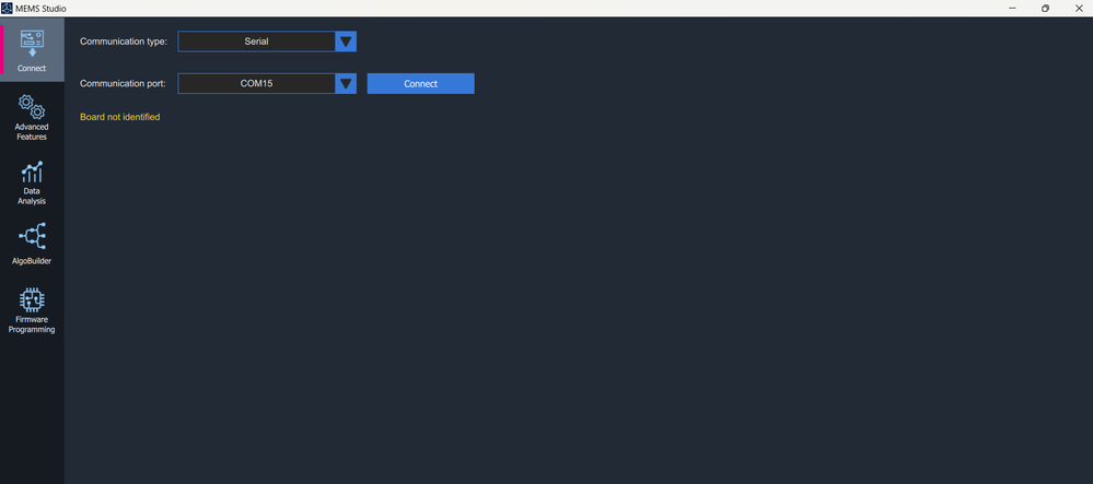

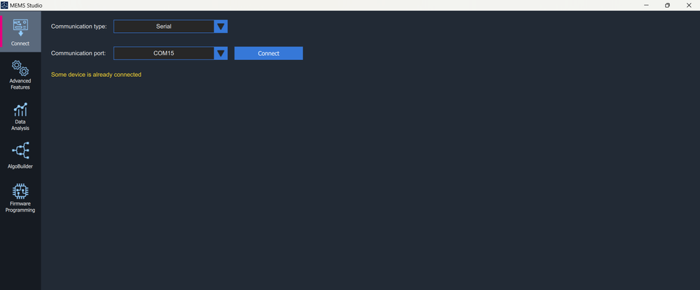

I have an X-NUCLEO-IKS4A1 mounted on top of a NUCLEO-L476RG and I am trying to connect that to Mems Studio. I get one of the two errors in the attached screenshots. Either "Board not identified" or "Some device is already connected".

The NUCLEO (STM32) must be programmed with compatible firmware with MEMS Studio.
You can check chapter 2.6 Hardware and firmware compatibility in UM3233.
NUCLEO-L476RG + X-NUCLEO-IKS4A1 can be used in AlgoBuilder in MEMS Studio.
Sensor evaluation firmware (DatalogExtended) is unfortunately not available for NUCLEO-L476RG, please check X-CUBE-MEMS1 package.

I do not have any project file. I have only connected the NUCLEO-L476RG to my windows device. I have the X-NUCLEO-IKS4A1 mounted on top of the NUCLEO-L476RG at the same time. I opened MEMS Studio and tried clicking on the Connect button in the Connect Tab after selecting the correct port number. This is the error that is being thrown. How do I successfully connect now?

the MEMS Studio opens the serial port and send "CMD_Read_PresString" command to read presentation string. This string describes the firmware and MEMS Studio can adjust the GUI according to the connected firmware.
The firmware from X-CUBE-MEMS1 will not work properly without appropriate X-NUCLEO board connected so it will not able able to respond to the "CMD_Read_PresString" command and the connection will not be establisted.

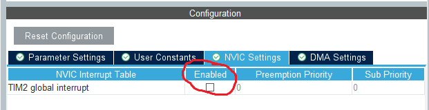

I don’t have the NUCLEO-G491RE available at the moment, but I did a quick check of your STM32CubeMX project. I noticed one issue - the interrupt from TIM2 is not enabled.
Please enable this interrupt and try again with MEMS Studio. I believe you should see the sensor data coming from the firmware. If not, please let me know, and I will try to get the NUCLEO board to debug the issue.

I can confirm enabling the interrupt for TIM2 fixes the issue with MEMS-Studio regarding to data acquisition with the NUCLEO-G491RE board.
