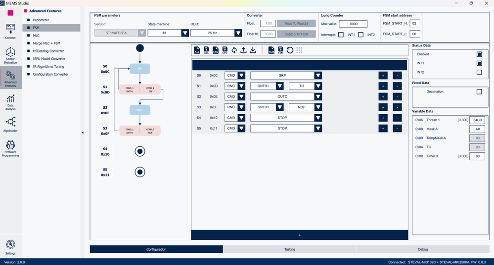

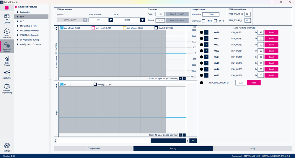

I have tested the free-fall configuration provided in document AN6207, but the results do not match my expectations. Could you help me identify where the issue might be?
My goal is to configure the FSM to generate an interrupt when the signal from the ST1VAFE3BX sensor exceeds a defined threshold.
More specifically, I would like the FSM to trigger an interrupt upon detection of a heartbeat event.
Hi @Luisa_97
We reviewed your Freefall configuration and we identified a wrong timer configuration since it is currently configured to wait 0 samples , that is different from what is suggested in the Application Note (3 samples (03h), see Timer 3 variable section parameter at address 0Bh).
Moreover in order to identify such event what we suggest is to use the vAFE signal as input, instead of the accelerometer one.
