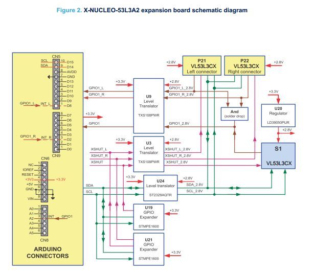

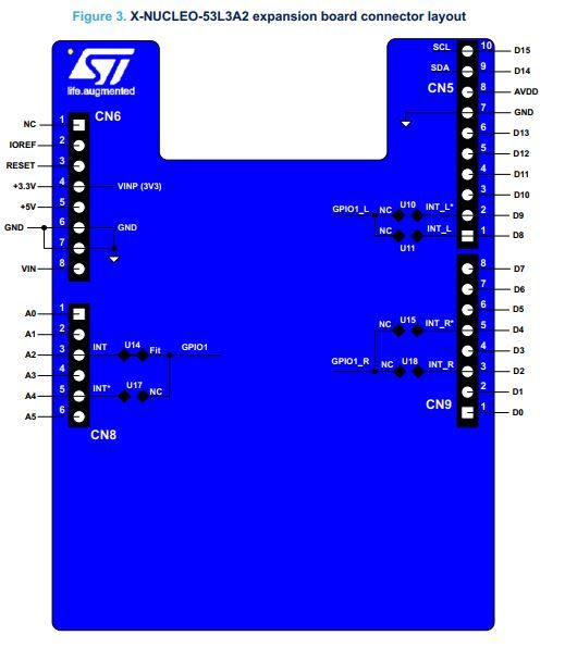

Thank you for your reply,I was wondering about the GPIO1 for interrupt,it's written:"the VL53L3CX interrupt of the left and right breakout boards, GPIO1_L and GPIO1_R, can be shared
with the VL53L3CX interrupt on the main board, GPIO1, by fitting U7 and U8 solder drops. By default
U7 and U8 are not fitted." So in order to activate the interrupt,and run the code successfully for the 3 sensors together,I need to solder U7 and U8 togther(to become fitted)?...Thank you in advance
John E KVAM
I don't think I know the answer to that.
But I can help you.
I'm including the PDF of the board. It will show you exactly what is being done.
this board is for the VL53L1, but because all the VL53 sensors have the same footprint, all these expansion boards are same. - We just changed the sensor itself.
  • john
If this or any post solves your issue, please mark them as 'Accept as Solution' It really helps. And if you notice anything wrong do not hesitate to 'Report Inappropriate Content'. Someone will review it.
May sharing this materials from VL53L3A2 USER MANUAL can help?0693W000005CMSVQA4.jpg0693W000005CMSGQA4.jpg0693W000005CMS6QAO.jpg
