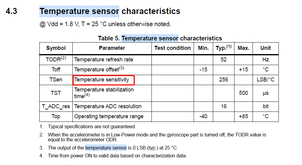

LSM6DSR 3D accelerometer and 3D gyroscope,I want to know the accuracy of the internal temperature sensor?
ZZach.1
From LSM6DSR datasheet,I can get the temperature sensor ADC characteristics,temperature sensitivity ,as following picture:
​but with no information about accuracy,that is difference between the measure value and the true value.
I want to know something about that,or maybe calibration table and graph of internal temperature sensor.0690X00000DXOymQAH.png
Thanks a lot.​
1 REPLY 1
Eleon BORLINI
Hi @ZZach.1​ , you are partially right, from the datasheet there is no direct evidence of the temperature sensor accuracy. However, the LSB value is 1/256 °C, but is is not the accuracy value, because the offset (meaning, the output). is +-15°C. This is the biggest limitation to the embedded temperature sensor. If you are interested in an accurate temperature sensor, I would suggest you to use the STTS22H sensor, 0.5°C accuracy. Regards
