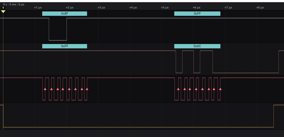

I am trying to read the "Who am I" register of a LSM6DSO. I get no response on the MISO line. I suspect I am not configuring the IMU correctly. I am using a Nucleo-L031K6 connected to a MKI196V1. I attached the code. Am I missing something in the configuration for SPI? I have the data sheet but still resort to too much guessing. Am I missing a document or code resource? Any help or code examples is appreciated.

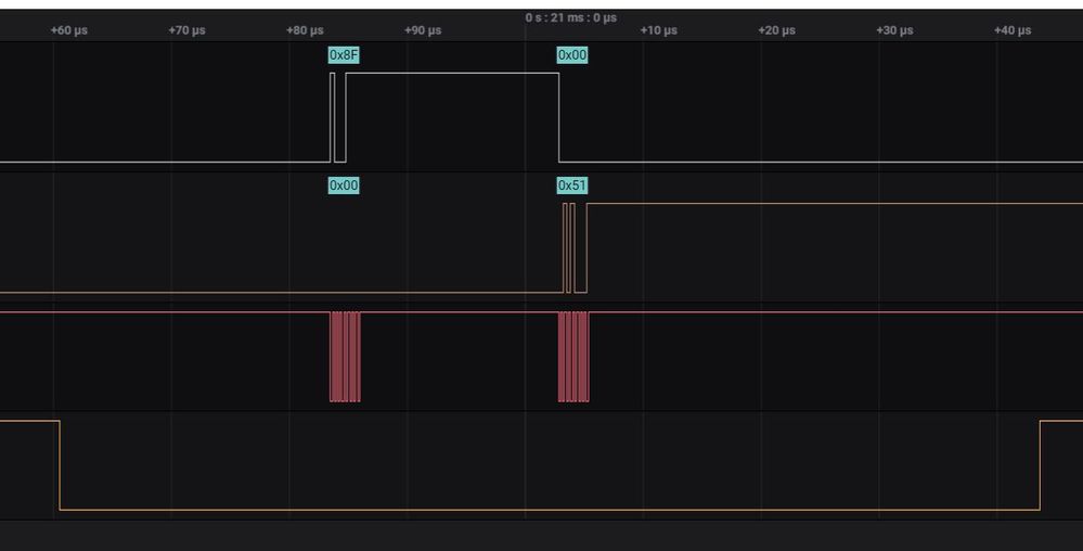

Hi Eleon,
Thanks for the reply. It was my understanding that the LSM6DSO defaulted to I2C. This would mean the MISO line was not active from the sensor until switched to SPI. Am I wrong here? I'll look at the examples again. They didn't help me much the first time. Examples of simple SPI read and writes to sensor registers would be a great resource. I'd pay for such a thing.
Hi @DJack.8​ ,
but are you able to correctly communicating with the device via I2C, and not with SPI?
This might be only an issue of LSM6DSO device pin configuration. You might try with the I2C_disable bit of the CTRL4_C (13h) being set to "1", in order to disable the I²C block.
By the way, I note down your documentation request.
-Eleon
I'm still chasing the problem of SPI reads after many hours of work. I compare data from a Nucleo-L053R8 board with a LSMD6SO IMU to data from the STEVAL-MK1109V3 development tool and the LSM6DSO. The development tool gives the correct response from the "Who Am I" register as 0x6C. The Nucleo board does not. The "resting" state of the MISO and MOSI lines are also different although I don't know if this should matter. I am also concerned that the development tool reads or write all 40 registers when the menu tab that displays the registers is selected. I'm not sure really what is needed to get to a reliable state for reads or writes. I can't find anything in documentation about this. I attached the code and waveform captures from the development tool and Nucleo board. Should I consider switching to I2C?0693W00000DnZ6TQAV.jpg0693W00000DnZ6OQAV.jpg

Read carefully the datasheet. Is the chip booting in I3C mode? Is it configured as SPI 3 wire interface?
